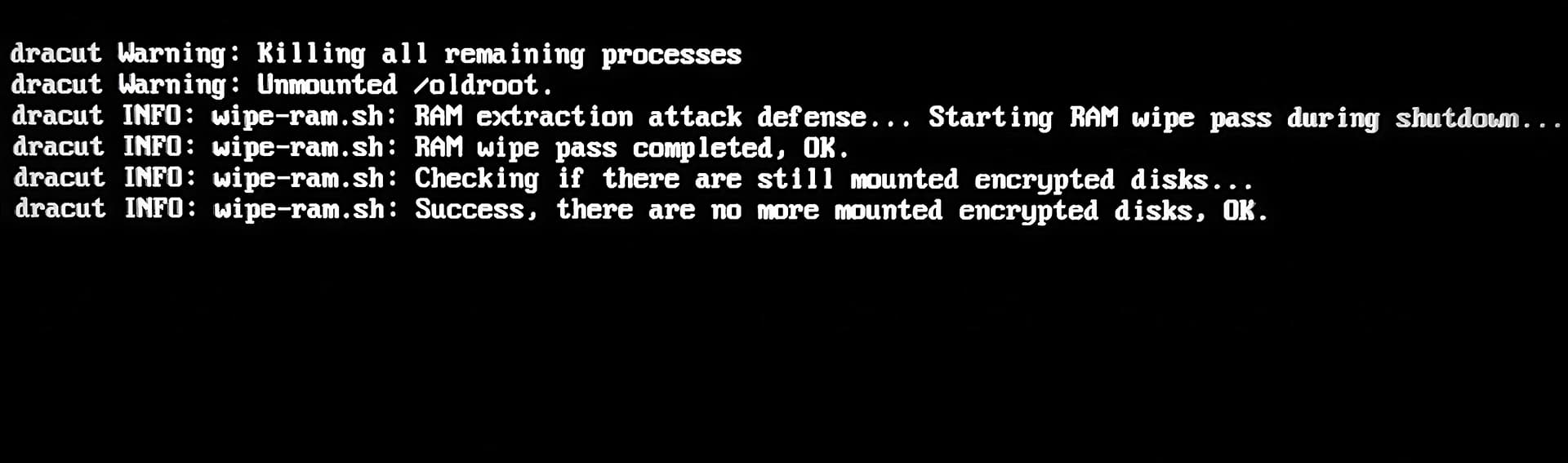

You will see new entries after shutdown Qubes.

How do I prove that the RAM wipe really occurred?
How do I check the logs, which logs should I look at, and what should I be looking for to know if these anti-cold boot attack modules really worked?
How can I prove that they actually worked? Are they really functioning?
List the commands we can use to check this since the logs of dom0 are different from Ubuntu!
You can check the triggers in the ram-wipe.sh file. The memory clearing works like Tails using this command:

This is a standard Linux kernel option for clearing the memory cache. You can look for it in the journal logs.
You won’t see these lines after shutdown if the clearing didn’t happen (for example, delete the ram-wipe-lib.sh file and those lines won’t appear after shutdown).
I try to check the logs from the journal with sudo journalctl > journalctl.txt. Entering journalctl.txt I couldn’t find anything either. With sudo journalctl | grep -i 'dracut INFO', I couldn’t find anything either! I tried all the words and full phrases from the screenshot you showed, and I didn’t detect anything in the logs… is it failing? Perhaps this is failing:

This memory‑poisoning operation echo 3 > /proc/sys/vm/drop_caches does not generate a log message by default. It’s a direct command to the kernel that runs silently. The kernel doesn’t log it. Therefore, the Kicksecure devs added a dracut-log indicating a successful operation. In the journal you can only see whether the module was activated or not.
